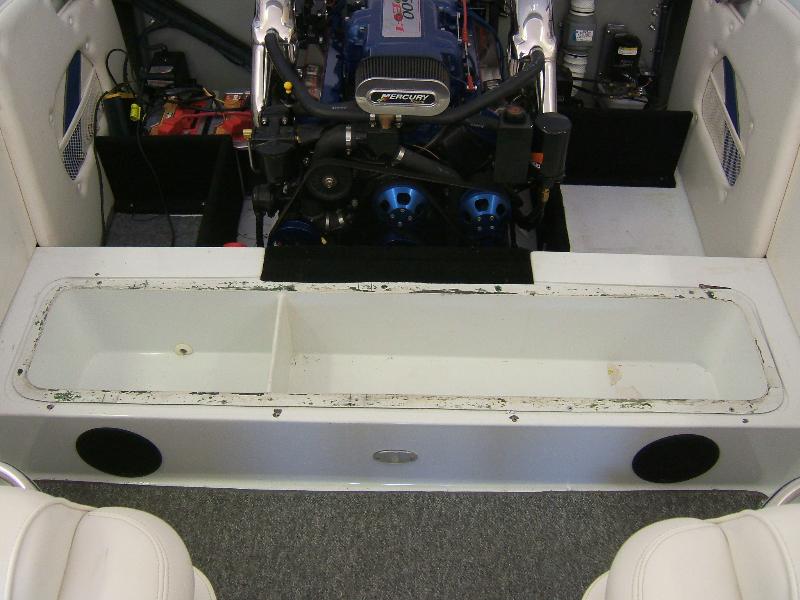

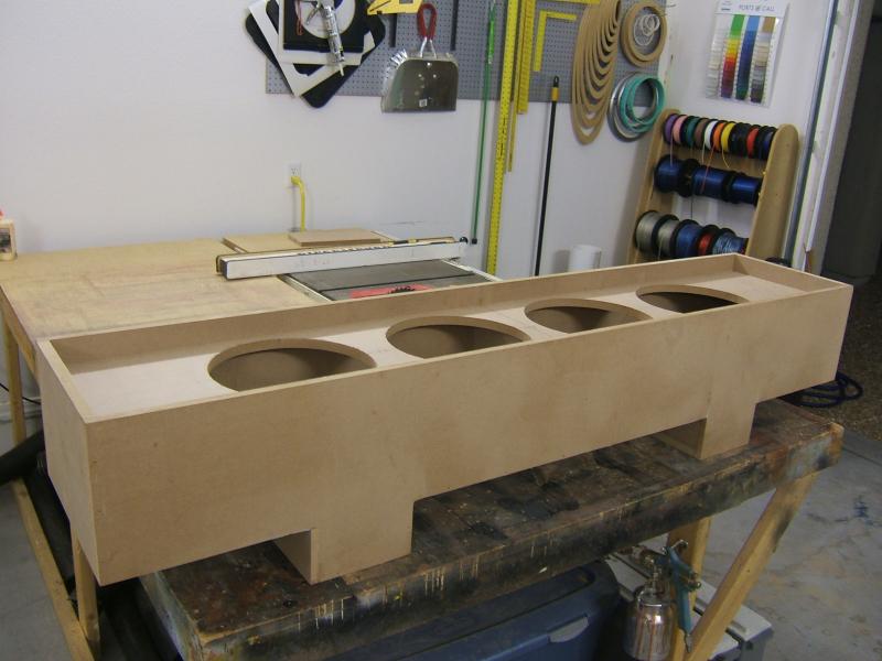

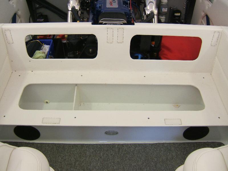

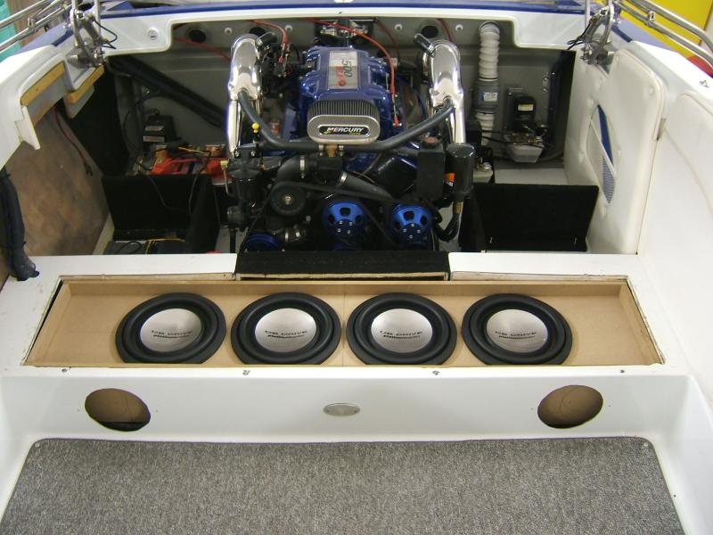

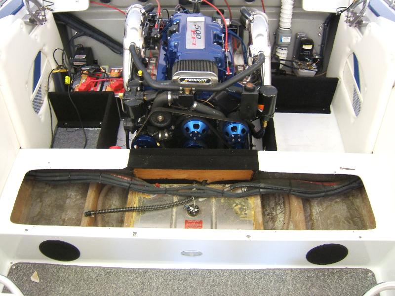

    no...not the fish . The owner of this Howard wants ALOT of bass and this is one of the harder boats to find extra space in so im replacing the rear under seat storage with a bandpass box for 4 12's.
    More pics later if anyone is interested.

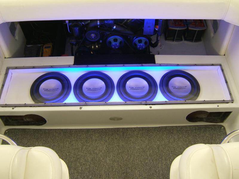

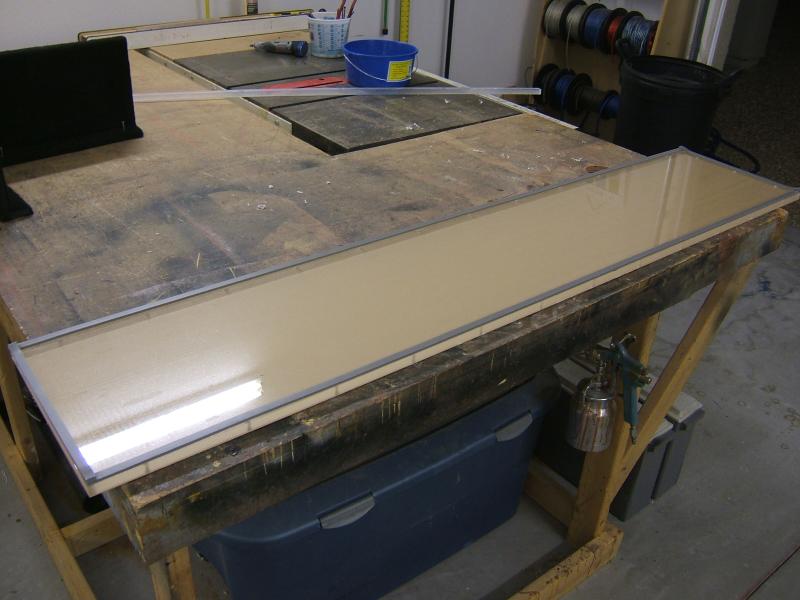

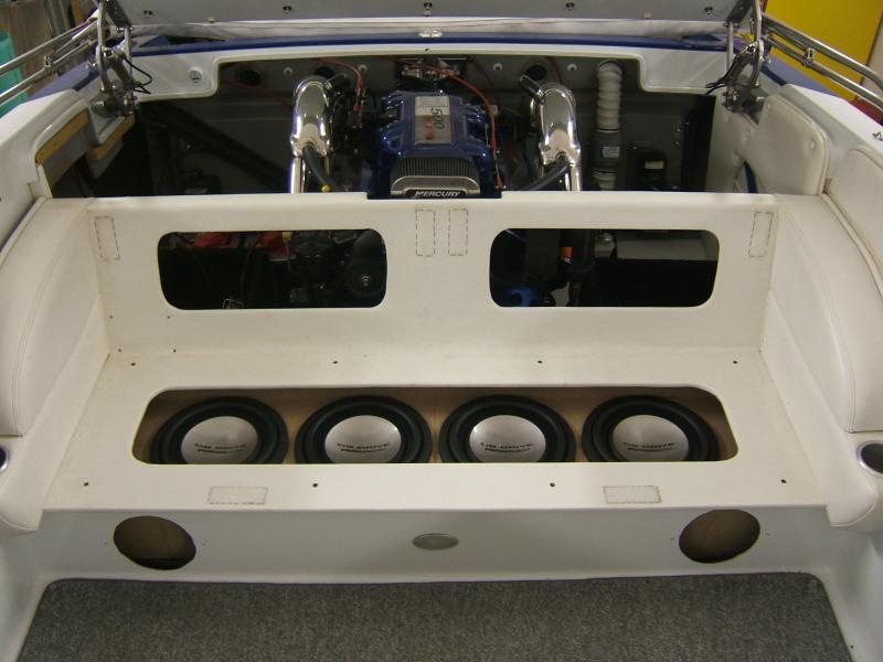

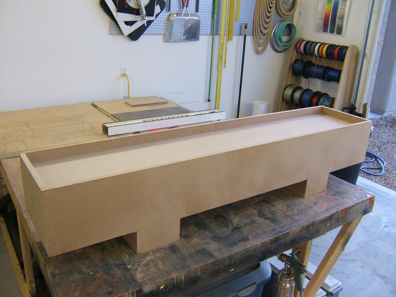

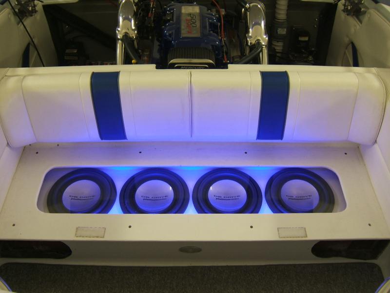

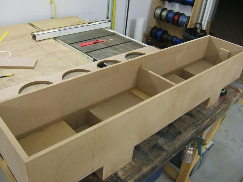

    Most of these pics are just "test fitting" as i go. When its finished, the entire box will be covered in fiberglass resin inside and out, it will be covered in white vinyl, the top will be 3/4" plexi, and it will have blue LED's lighting the subs up.

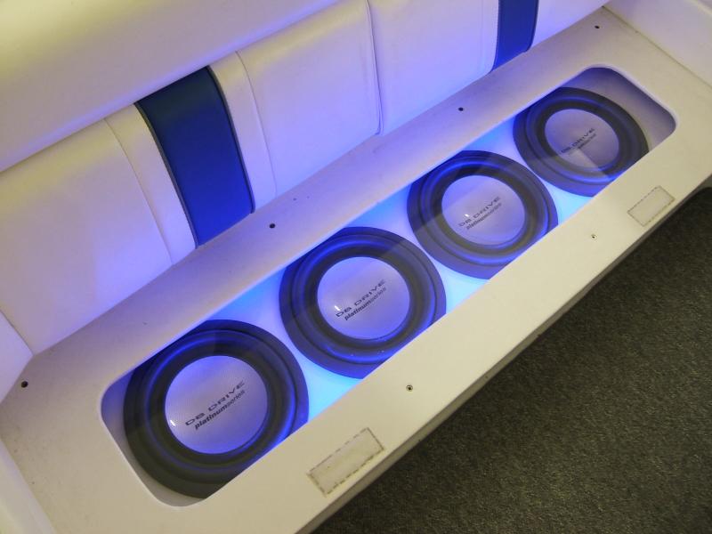

    Its getting close. I should have it playing by 3 or 4am tonight and completely finished on Sunday.
    too many irons in the fire + no A/C in the garage = S L O W this week.

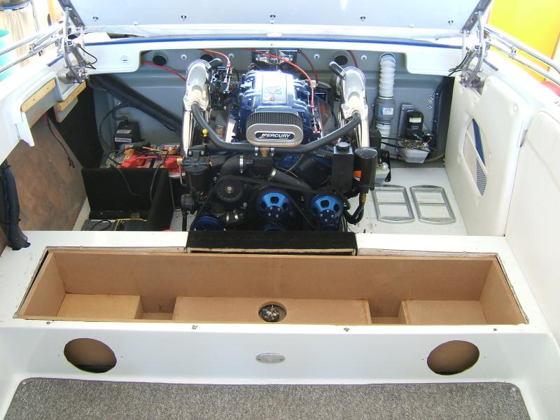

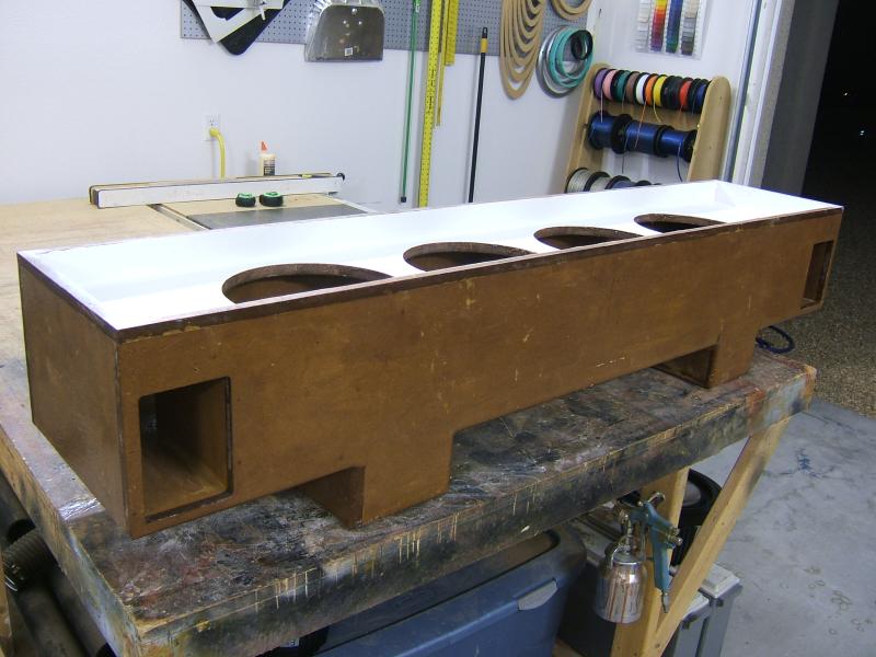

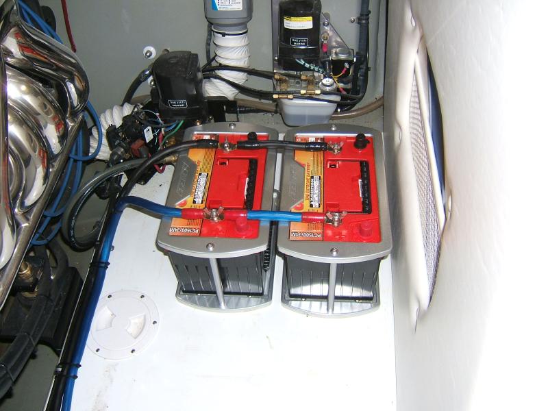

    Ended up going a different direction with the ports. I couldnt get the 6" pvc to fit like i wanted so i switched to MDF. Just have to make some trim panels now to cover the old 6 1/2" holes and dress up the new ports.

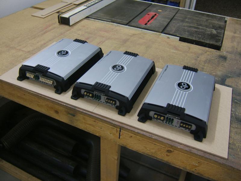

    Also added 2 more Odyssey 1500's.
