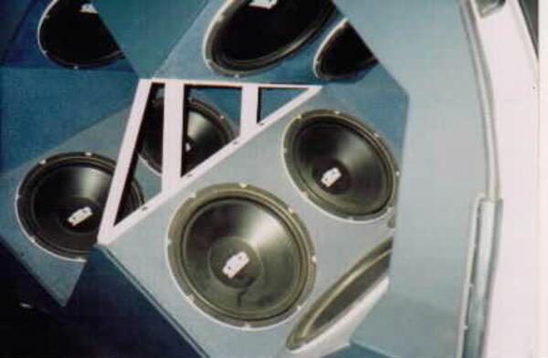

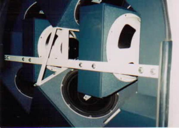

    Just for kicks...here is an OLD install my cousin and I did back in highschool in his extended cab s10.....keep in mind this was the early 90's....lol...didnt get into fiberglass for a couple more years.....
    That ended up being too much for him(hard to tell but there were two tens per side). He eventually went with just two tens....I still have, and use, the other two....lol... I tried like hell to talk him out of those rear fill mids....oh well....his ride, not mine....
