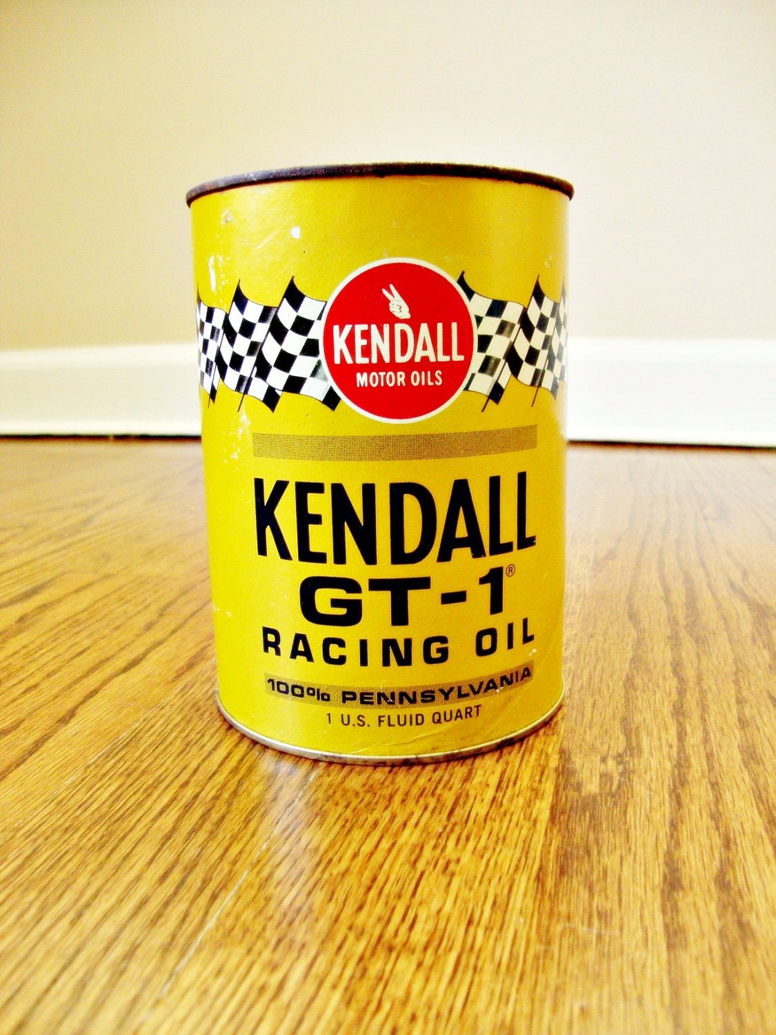

    Just so you know, this is NOT Kendall Racing. See the word RACING anywhere on that label? This NOT the oil Teaque was refering to when he made that suggestion.
    This is Kendall Racing. See the word RACING? This is the oil Teauge recommended when the boat was built 40 YEARS AGO. This is no longer available.
    The SAME oil is available as Brad Penn. This is EXACTLY the same oil as Kendall Racing, from the same refinery.
    Now you have the info, what you chose to do with it is up to you.
    You were told this back on post #3.
    gn7
    gn7 is offline
    Senior Member gn7's Avatar
    22,012
    Quote Originally Posted by rat flatty View Post
    thanks guys for the input.. i havnt ran my boat for three years and almost forgot what wt. to run..you know teague is the one who built and set up my flat in the early 90,s and he recomended only kendall racing oil..its still out there cause every time i ran my boat rather it was for 20 seconds or 3 hours i changed the oil before taking it out again..and with a 17 qt. oil pan it was a couple hundred bucks a run..like i said i got the river fever and had to get the oil from some ware.and auto zone here i came..i put the vavelln 50wt.racing oil and plan on warming up the heck out of it before i get on it..id just wanted some feed back..btw any one going to needles this weekend that wants to try to out run the rats ass, PS flat ILL BE THERE.. send me a pm and we will meet up.and no billy b. your not invited,only as a spectador.. your wallet is deeper then mine wich turns into mph..lol
    Just so you know, this is NOT Kendall Racing. See the word RACING anywhere on that label? This NOT in anyway shape or form the same oil as Kendall GT1 Racing oil. Its not even close. This NOT the oil Teaque was refering to when he made that suggestion OVER 40 YEARS AGO
