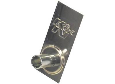

    Get yourself a K&N breather, or something that fits the VC hole and run it to the underside of the air cleaner. The crankcase needs to be open to the atmosphere somehow.
    You can install something like this to the underside of the air cleaner base
    LINK: air fitting
    Or you can get these in different hieghts that fit between the top and base of the air clear up against the element.
    But you need to get the other side of the engine open, or the engine will build up pressure when the PCV is closed. Its NOT always open and pulling from the crankcase. It PART of the reason your fuel pump is spitting oil.
