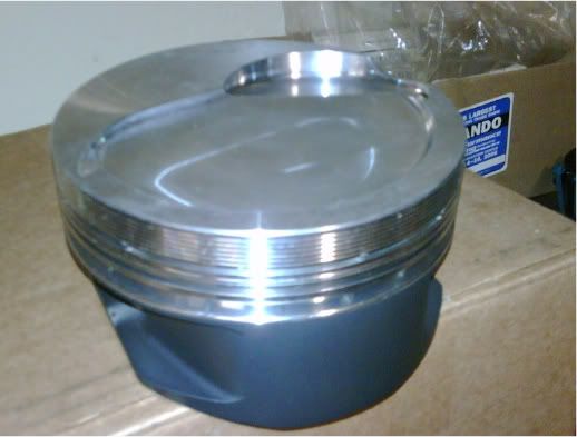

    This happens to be from the Wiseco web page:
    " Vertical gas ports are primarily used in drag race applications. Lateral gas ports are more often used in circle-track and road-race applications where carbon build up can occur. When gas ports are used, pressure is directed to build up behind the compression ring and seal it against the cylinder wall. This helps prevent ring flutter and extends the power curve upward in the RPM range. Vertical gas ports have the holes drilled from the deck of the piston into the top ring groove and behind the ring. Lateral gas ports are drilled through the bottom side of the top land and extend to the back wall of the ring groove"
    Travis for your boat application ( long term minimum tear downs) I think you would want to go lateral ports.
    A benefit of running gas ports would be (is) to reduce the compression ring size ( remember the most friction in and engine comes from the ring pack) if you can take the top ring down to .043 or so and reduce the tension and then let the gas ports do some work for you to reduce ring flutter you can still get a good ring seal and reduce friction. Best of both worlds right there.
    That's my understanding on it, there are a couple dozen ( at least) guys reading this that know far more than I do on the subject but that's my understanding of the situation. On this subject like many I know just enough to be dangerous
    My new pistons have lateral gas ports: 13:1
