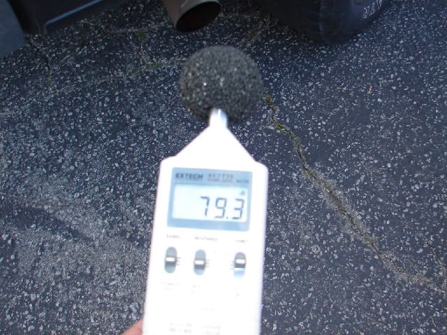

    Like Greg said theres lot of muffling devices to choose from out there , the majority will knock down the noise 8 to10 decibles depending on the engine itself (compression ratio etc) and how and where they are tested and for that matter who tested them (sae methods etc) a few years back we bought a certified decible meter and set about testing and found for example on Josh's and my boats we could get the from 110db or so down to around 90db with what most of us were offering , to get them down to 86db took internal Loovered mufflers and Drew Shot guns both , water injection helped bit may not be a factor on some types of test one might be subjected to, it would appear that many states have adopted the (j2005) Surprisingly although commonly thought to be a big HP "scrubber" however reports and feedback suggest (mufflers) don't seem to be all that bad , especially when contrasted against an expensive ticket or maybe a "boat and driver shake down inspection" by LEO .Lately we have been getting calls from alot of folks in different parts of the country saying they were denied launch altogether at public ramps in certain venues and in some localities weve heard OT pipes/ headers of any type are banned (private or municipal lakes). As much as I hate to face it the loud exaust noise I have always loved is likley going the way of lots of other things in this country Tom
    PS heres some things to consider when I spoke to a director for Harbor and Navigation a couple years back re this subject he said at that time training included comparing a loud boat (observation) to a gas lawn mower etc . some of the DB test we did at JBP just for S&Gs were to test Joshs 02 Silverado with a single stage cat back Flowmaster , it would have barley passed the "Dock test"
