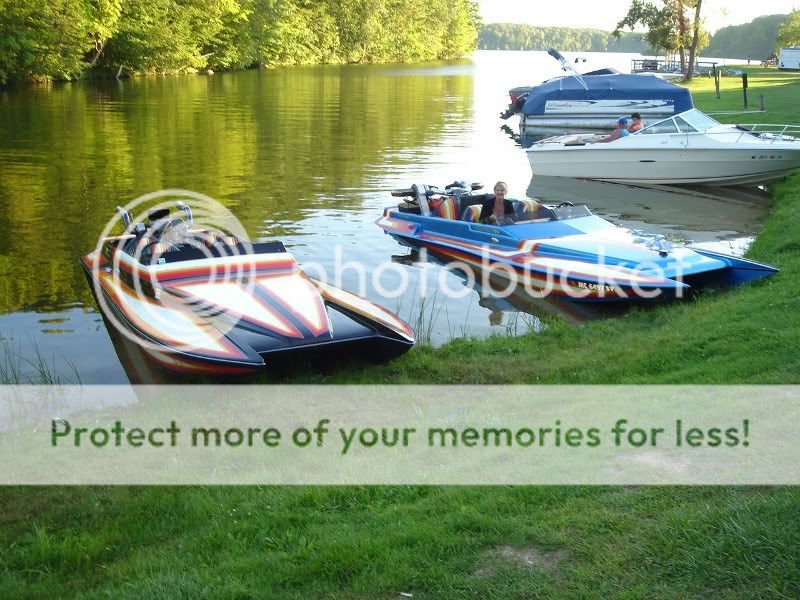

    Had some fun running along with this Texas boat who was visiting,
    I look for him to come back next year with a serious turbo engine program similar to Hass.
    He's a fabricator and can make it happen.
