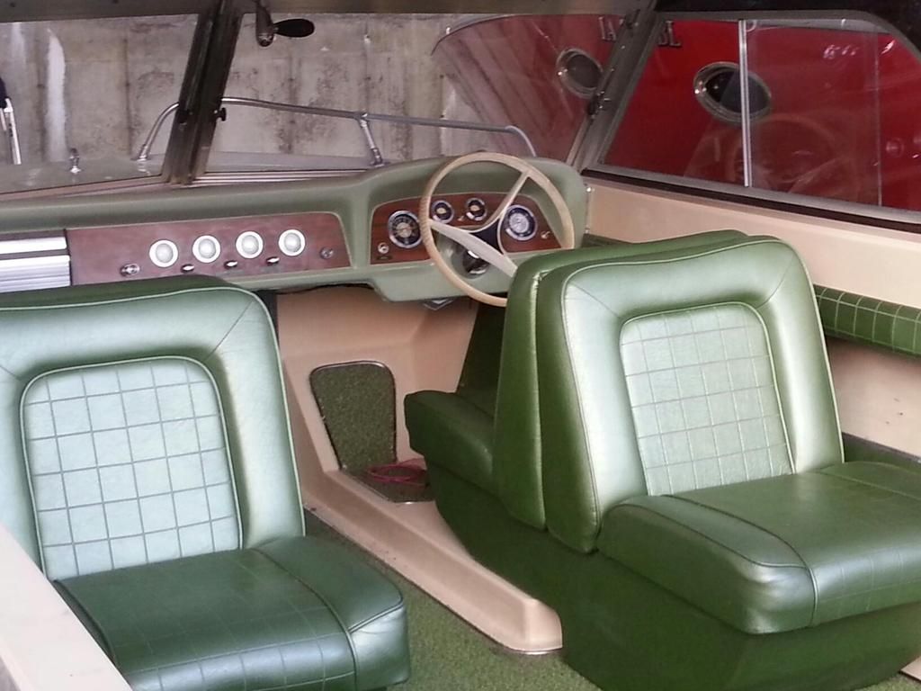

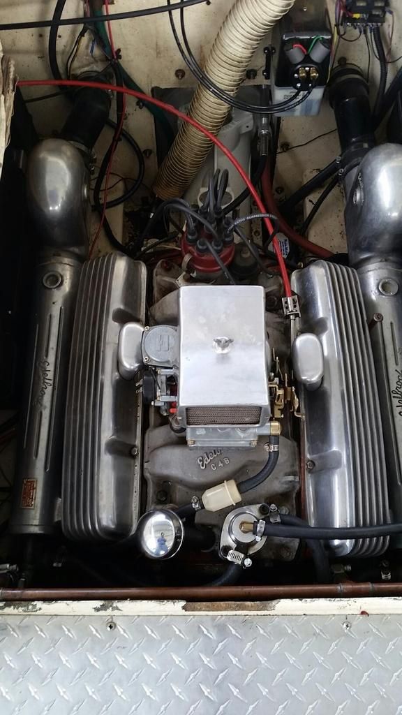

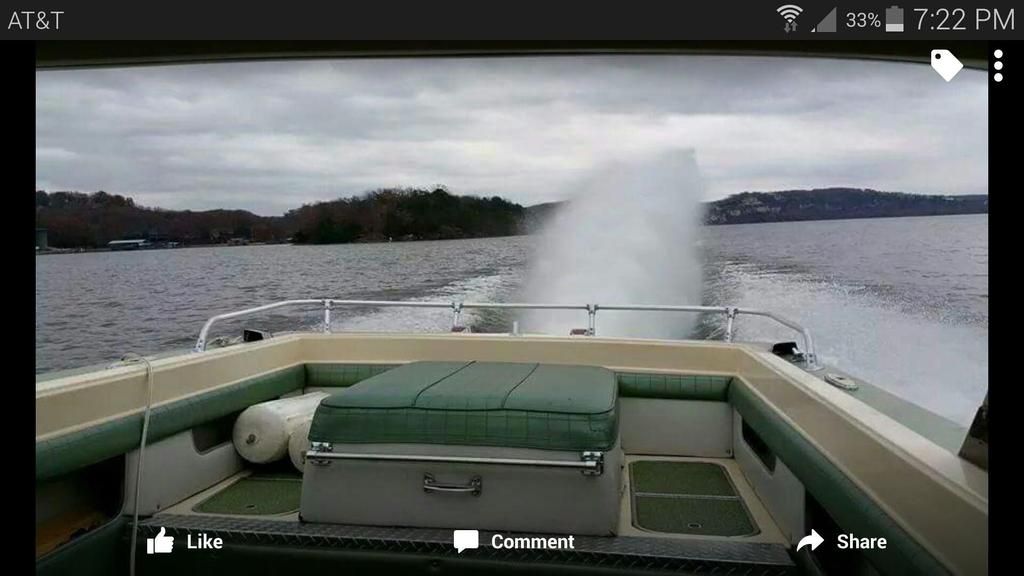

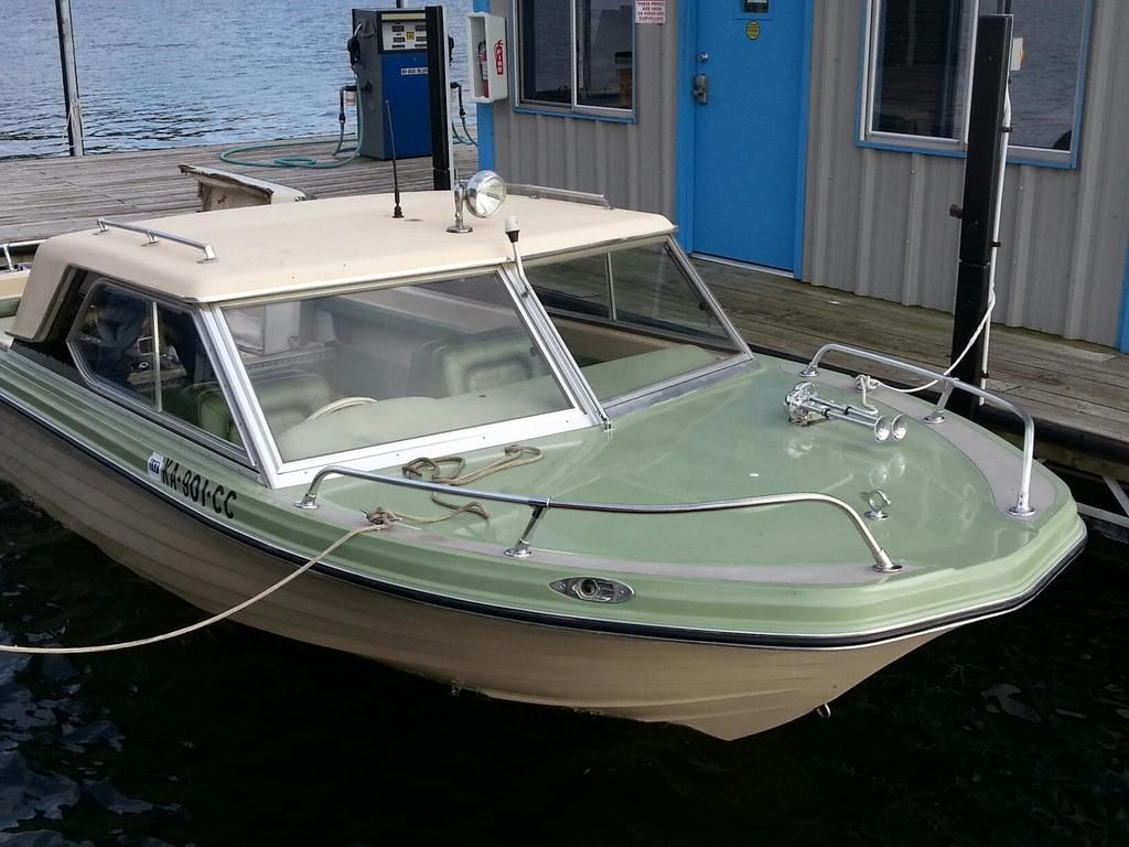

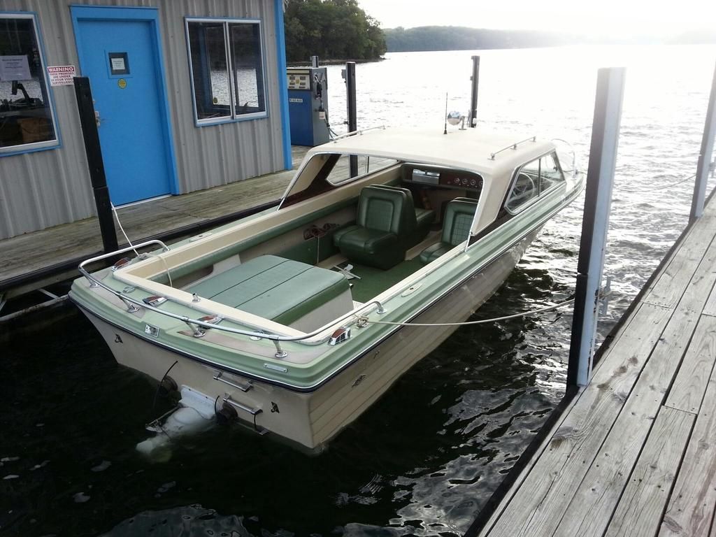

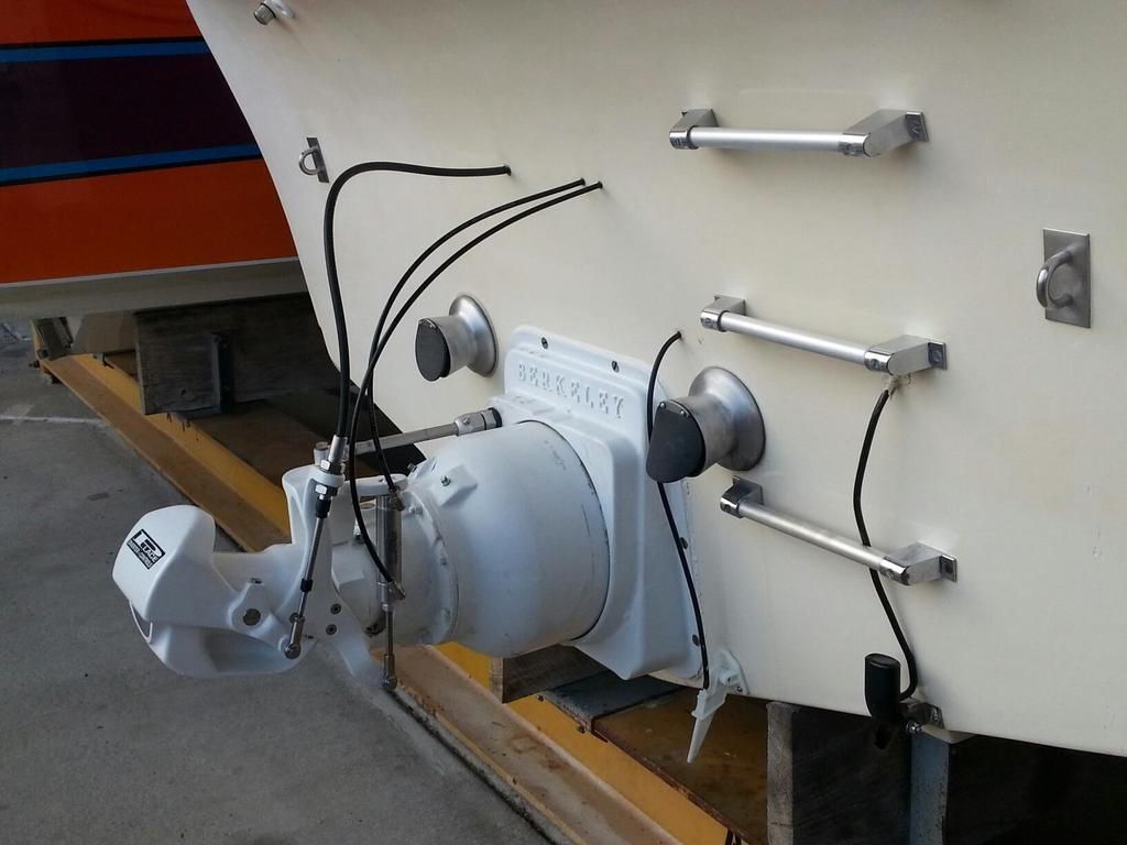

Just recently bought this boat from a friend. Don't know much about it, but it seems pretty unique. Maybe someone can educate me. My friend said it does about 40mph at 4500rpm. He is not sure if it is getting WOT so I will check into it. Just trying to learn what I can about it.
327 with Berk pump
Edelbrock log headers
Edelbrock risers
Edelbrock intake
Holley 600 carb
Mallory distributor
Through hull exhuast
Place diverter

cool set up, never seen one before, that hull design will never be fast but it looks very clean and well done, enjoy the ride!!

IMP = Iola Molded Plastics. Built heavy and handle the rough very we'll. Aztec is a 20'r if I recall. SBC and a squirt drive isn't ever gonna be fast but that hardtop is rare and in good condition.
I really wouldn't spend any money trying to make it go faster...just add some cocktail holders and enjoy some early evening cocktail cruises.

If this is your first jet drive, know that the boat will only turn while under power. In a panic situation, normal response is to get out the throttle...that'll make the boat straighten out...turn hard and throttle harder to get around and thru whatever pops up in front of you.

Just looked thru pix again and spotted a no-no. Ditch that plastic inline fuel filter up by the carb. Plastic can become brittle with the heat in the engine compartment then split. Same filter is available with a metal housing...go find one please.
16 Posts
Discussion Starter #16
Thanks for pointing that out. I will get that changed. If anyone notices anything else that could be improved please let me know.

Another pass thru pix and spotted the old school intake manifold with the oil fill tube there rather than in the valve covers like later models had. Guessing that this thing is all OG (original).
<<< lots of smiles again...
16 Posts
Discussion Starter #18
Yes it is. A speed shop in Lawrence put all the edelbrock parts on. The Holley carb is newer but the rest is unchanged

Take the flame arrestor off and check if the Holley has the vent tubes which are curved back toward the venturies. If not get a marine style because if it ever floods over and starts burning it will be a sad day.
Auto carberators have the wrong power valves and main jetting and . And like was said before, replace the fuel filter.

2 more...I see a flag pole mount on the stern deck, center. Get yourself a small wooden flag pole and fly Old Glory proudly...
Secondly, does the all around white navigation light forward of the windshield extend up and light with the red/green and stern 180* light? USCG rules have changed and require the red/green Bow lights AND a 360* all around white 3 meters above the highest point on the boat. I'd guess that the bow 360* is switched to light only as an anchor light and is off when red/green and stern 180* are on. No issue if you don't boat at night but it's not compliant if my guesses are correct.
