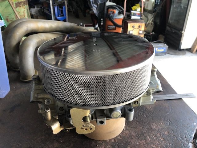

"Quick and Dirty" = I used a dingle ball hone at the shop and honed it myself and put a new set of rings in it with lots of help/direction from old friend Geoff Mummert (I watched a lot). This engine has been together since 2011 and has many river miles on it and nitrous passes. I hurt a couple pistons back in Oct running on the bottle. We also put a different cam in it to try out a couple concepts we're working on. The new cam is 275/276 at .050" with a lobe lift of .455/.421 (1.8 rocker) on a 113 lobe sep ran straight up. The old cam (that made 948 hp at 7,200 ) was 281/286 at .050" with a lobe lift of .435/.438 (1.8 rocker) 113 lobe sep and advanced 4*. We shortened the duration up so we could keep the power numbers in the 7,200 - 7,400 rpm range. Peak hp target was 7,200.
Anyway, after getting a good baseline for the single 4 1,200 ( carb built by John at C & J Engineering) I put the flame arrestor on the carb to see what it would do.
3" tall flame arrestor.
Run 8 - no flame arrestor:
Run 10 - Flame arrestor:
We never leaned on it with the single 4. We were just getting a baseline. We didn't even re-jet it on the dyno. Had we worked and got the oil to 180* and pulled 3 - 4 jets out of it to get the AF closer to 13.0 she would have made a bit more power and topped the 2011 single 4 number. We just didn't chase it, because we wanted to spend time on the TR.

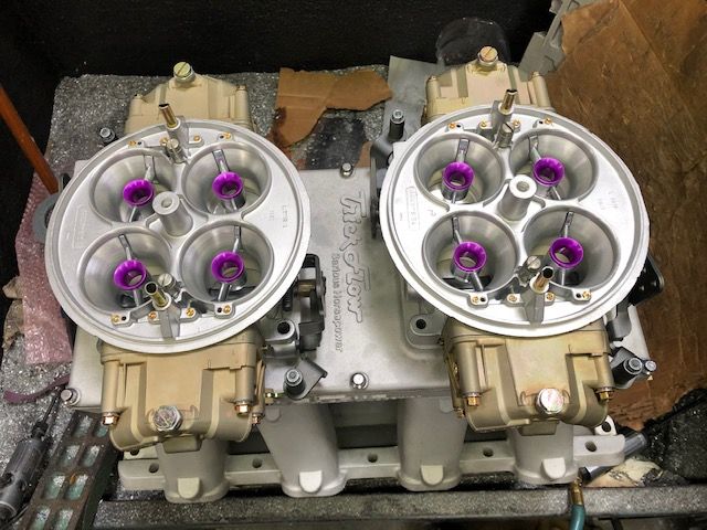

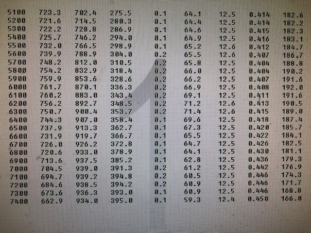

After the flame arrestor change we did an oil change and then a few more changes including the tunnel ram and two 1,050's:
The results were pretty good, but there is more to be had.
John at C&J Engineering did the TR carbs as well (I might have been his Customer of the Month in February) and they are damn efficient with their low .4 BSFC numbers. They look damn good too:
I had both carbs- sent them to him to make a "matching set"
There's more to be had, so we'll be going back in May shooting for 4 digits.

One thing about the flame arrestor ... When we go back I'll have two of them with some mods to place on the TR. I think they'll actually help the air flow to the carb and help the signal. The engine is pulling between 1,150 - 1,250 cfm running the single 4. With the TR the demand on each carb is cut nearly in 1/2. The flame arrestors should be able to handle the flow of 650 - 750 cfm each and not be a restriction. We'll also have a couple of K&N filters on their velocity stacks to test as well.

Tunnel Ram dyno pull:
Edit:
If you click on the top of the video above it will take you to the link with the TR run.

Why did you stop the pull in the tunnel ram test at 7400? She was still pulling hard.

A couple reasons:
In the jet boat it won't see over 7,200.
With the 275* int duration we were a bit surprised it was still climbing. We could have advanced the cam ( belt drive on the engine) but seeing that the engine was going positive crankcase psi above 6,800 we figured we were down 10 hp from if the Vac pump were pulling -1.8" ( that's what we saw between runs 8-9-10)
Also, we ran into some intake tuning issues that we couldn't fix in this dyno visit. At that point I knew we'd be headed back with the GZ vac pump installed and some intake mods.
When we go back I probably will take it to 7,600 to see what it does, and then we'll advance the cam.

Crazy brake specific number!
For your flame arrestor test, what about making a funnel shaped base? Or a funnel type base for a tunnel ram type flame arrestor? GT Performance used to make some up with a very open wire mesh, or you could pull a couple of wraps out of the ones you have?
I'm going to get a couple of dominator short air bells to attach the flame arrestors to. I think that should work well.
On the brake specific .... We could have tuned some more on the single 4 and got it better, but it's interesting to see that the TR was using less fuel per hr making it's 970hp than the single 4 was using making 940hp. When you account for the extra 10 hp the single was benefiting from with the Vac pump, there's another 10 hp gain the TR set-up could have been showing. The BSFC could have been even better.
I've had a single 1,050 since '91 (originally tuned by Barry Grant ) since then John at C & J has had it a couple of times. It's been the most efficient carb I have ever seen. This is a dyno sheet from Westech in 2011:
Steve told me " if you ever want to sell this carb call me first"
I sent that carb along with another 1,050 body I had to C & J and told John to make a matching set. He has all the specs written down if anyone wants to call him and order a carb ( just don't forget to send me a finders fee ) ;)
This is what I was thinking, but these are back-ordered until May 28th. I need to find a different supplier:
K&N might make something that would work, but I do like this part.
See if it's in stock here maybe? Quick Fuel Carburetor Air Bells 200-2QFT
Or see if Brule has a matched set of the salad bowls you can test!

On the flame arrestor, can't you find a larger one and remove the inner screen for more airflow? That one seems small for what your doing.

I think I've seem a 5" flame arrestor in years past.
If I have sometime I'll look for them and see what they look like and cost.
