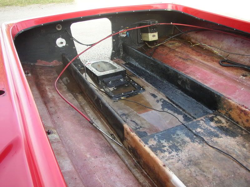

didn't want to highjack WindWalkers thread. I pulled the carpet out of the TX-19. Tried some adhesive remover I got at Ace. It takes the glue right off but you can't leave it on too long cause it will attack the resin. I just use a bondo spreader to scrape off the glue, then wipe it down with lacquer thinner. Will post more when I finish.

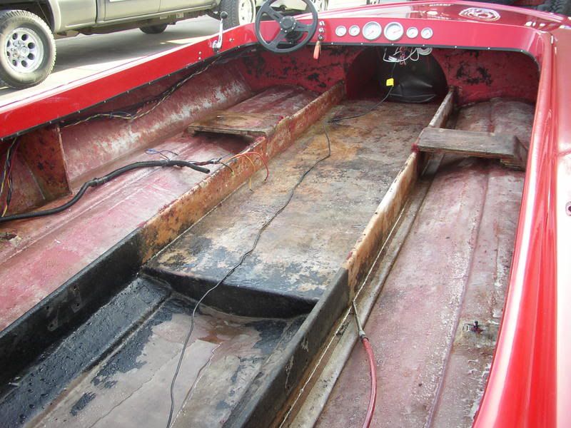

I just pulled the floor out of my 19 and weighed it.
33.5 lbs. I'm not going to put it back in. It doesn't sound like that much, but when you lift it's pretty darned heavy. 3/4" plywood resin coated (mostly) and carpeted.

The "V" in the bottom cradles the precious ice chest very nicely. Actually less prone to tippage and slipage. Keeping it well stocked (weight) helps as well.
33.5 lbs! Couldn't believe how heavy that stinkin piece of plywood was. Why..........that's about the weight of a 40 qt ice chest stocked with river pops and ice..

Cut out the subfloor & made a new front bulkhead. Subfloor weighed 58 lbs.

Painted the inside with epoxy. Got my pump back from MPD, it's in. Rail kit is done
. Ready for motor & staighten out the wireing
