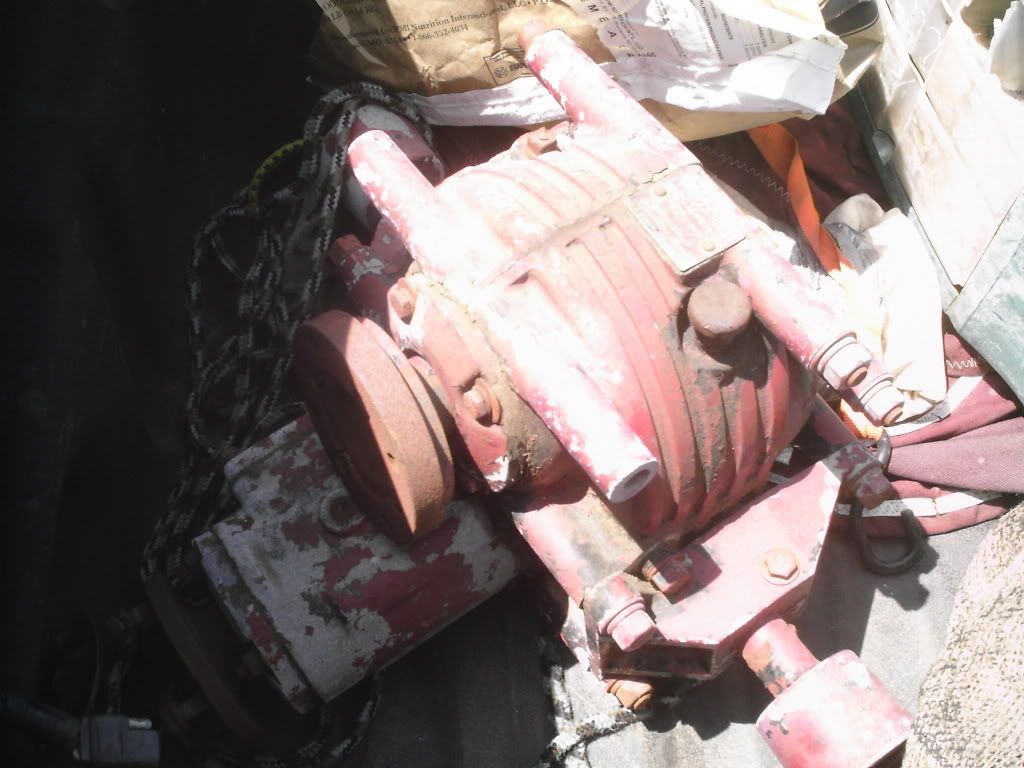

I would assume it's around a late 60's early 70's model. Made by crusader marine, Serial # V4589, 20% ratio, LH rotation (left hand?)
Haven't found out much about it. Picked up a 1965 custom flatbottom with a built 455 olds and trailer for free. The boat does need restoration, but the engine is in tip top shape. Apparently theis v-drive is the only thing wrong with it, and I have to get a short shaft made for the output to the propeller shaft coupling. Anyway,

crusader v-drive by thermo-electron corp. 12 % box to my knowledge only gear sets were 1.15 over 1.29 over and 1.77 over or under drive.
i have one of these in a 1973 flat the tag says rotation right or left on mine.
top plug left of pic oil dipstick
top plug right simple breather
plug on side by mount is a water cooling port/ there is one on opposite side also
I have had great service out of this, box gears are 2.6 wide and tuff as nails
send me a pm for some pics and i have some names and numbers to a guy hording parts for these.

I double checked the tag on the v drive and it def. says ratio 20% and Rotation LH. I remember the owner told me there was no reverse, so that makes sense. I also noticed that the cooling plug on the left side you mentioned wasn't even there, just a hole where a plug went. Where would these plugs route to for cooling?
The 455 has Edelbrock everything on it, including Edelbrock M3 water "log" exhaust, routed straight through the hull. No snails, just straight pipes. I noticed these have inlet/outlets for cooling lines but would you happen to know which is which? I assume the upper fitting is cooler inflow and lower is warmer outflow to the engine? I have the Holley 4 barrell taped up until I get a breather for it. Here is a shot of the engine, it's ugly but it turns over nice and smooth. Shouldn't be hard to get it started.

my guess is the dog on the lower section of the v-drive box is a neutral. as for the gear set you can ck how there in by marking the upper and lower shaft and turn them and see if it was set up under drive or over drive...but my bet it is under driven
as 20 overgear the engine and weight combo of the boat would not pull very well without a lot more hp.

you might ck out classic v-drive club online this will be a great source for parts also post on this site in the parts spam for anything wtb or sell have found these guys to be very helpful.
as for the v-drive box in 30 years i have only found one guy that has parts for them so if you need anything i shoot you a name and number he is in California area
