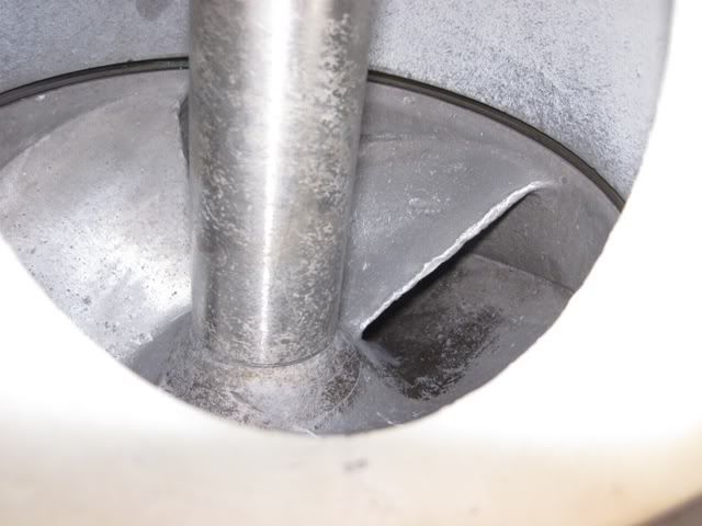

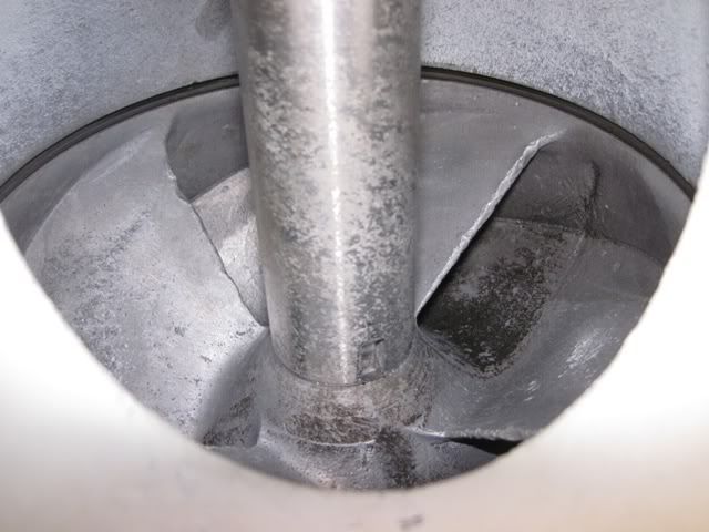

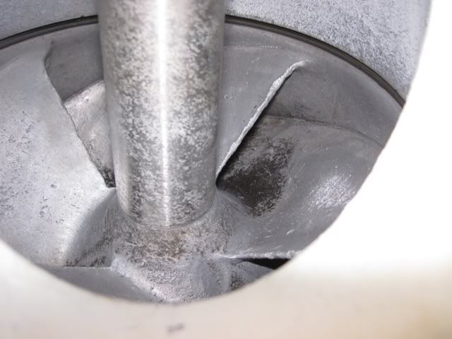

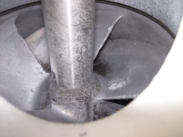

Here are pictures of my Berk Pump. Each one is of a different fin. To me they look kinda beat up but I don't have too much to compare to other than pictures of new ones. Engine is still out and I'm leaning more towards pulling this out right now and rebuilding it, but can't get the proper motivation to do the job. What do you think?

Just have the impeller blades cleaned up, no biggie. No need to buy a new impeller. Jack at MPD cleaned up an impeller for me that hit a rock bar last summer. He did an awesome job on it. It was way worse than the pictures above.

Likely on any given bowl with some minor "dings and divots", you can "work" the edges with a diegrinder and file. I would agree the impeller above looks pretty grim (especially with the inequity of the leading edges of the blades) , some work cleaning up and indexing the blades may net you some more time out of it but honestly for the price of a new or "reconditioned" impeller I'm not sure I wouldspend the time or the $ to resurrect particular one that one just my 02 ...Tom

leading edges as dinged up and rounded as yours are, are a recipe for cavitation. i'd pull the pump, take it or ship it to someone that knows what they're doing, like mpd, to clean the whole thing up and make sure everything is right and assembled correctly.
it's one thing to take a pump apart and put it back together. it's another thing to take a pump apart, check for every deficiency, correct all the issues and reassemble a pump that's within spec.
