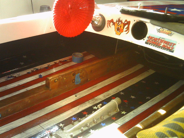

Thanks
Appreciate your comments, it was difficult deciding what to do with respect to making a pigs ear look pretty for the Blonde. And if anyone has worked with West Systems, you know how long it takes before you can touch or step on the stuff. Yesterday I started drilling holes to mount the hardware....Whoopee! Now, pressures on to not screw up! Oh, the blue tape is plugging the final liquid filler that plugs the needle injection hole that saved the stringers. Kinda feel like a Doctor of Delam.....:p
You can see the color change above and around the tape which is the new resin bonding loose glass. Forced from below with a vet 2 oz syringe, its interesting to watch it spread into the cavity. Then the clamps and 2X4s squease and spread it flat again. I figured this area needed strength with the cav lock handle mounted into the 4 holes and of course the dropped driver seat area.
Today is Casale tear up, have to rob gears from the Shark for Charley. Guess I'll start with 15s with its small prop and low reving stocker. Might hit 70:D
Another challenge is polishing the rusty chrome hardware before install.
