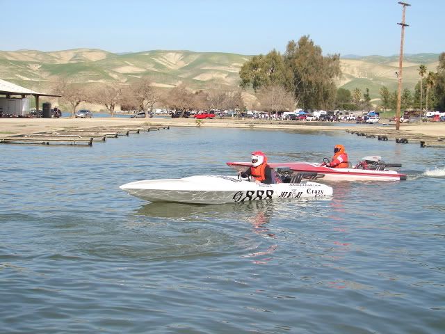

Brad, Black to white and on the water that quick.......Nice!:D
How was it the 1st time out?
its a whole different beast.....
the raspberry plowed through the chop and rode like a caddy....this thing wants to dance on the chop. im still getting used to it and getting confident driving it....the first time i drove it was saturday morning in the first heat....
