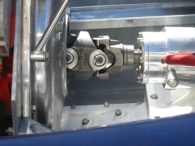

O.k. putting the motor in the gullwing. Seem to have issues with the jetaway. The u-joint yoke is stuck on the splines. I'm guessing since there is zero play on the splined shaft that this is where I'll have to get my clearances, but it doesn't slide and won't even come off. When I got the jetaway the yoke was already affixed to the shaft and I figured that's just the way it's supposed to be. Now I'm guessing not. If I try to use it the way it is now, I'll surely be putting undue pressure on the crankshaft and I know that's not good. Once again there is zero play forward and backward on the shaft itself.
I attempted to get the yoke off the splines by gently prying on it with a crow bar and it won't budge. It's like it's a press fit and I'm pretty sure it should just slide on.
Help! Anybody that knows these things. I could sure use some info (in particular how to get this damned yoke off the splines). I tried to call Duane Oblander, but there's no answer at the shop. It is probably lunch time though so I'll try back later.
I'm afraid if I put too much pressure to it, I could screw up something in the jetaway. The only thing I could think of would be to put some heat to it, and possible some penetrating oil. The yoke was badly rusted when I got the deal and that might be contributing.
Here's a couple pictures of it.

Dan, put a good penitrating oil and let it sit awhile. I had that problem with the cruiser and it took some doing to get it off. I used 2 long prybars and alot of muscle with a few quick raps with a hammer to shock the rust and then it came right off.

I would use a puller, or a press, maybe a little heat to the yoke. It does not take much of a burr to lock those on, although it does take some force to get them on when it has a burr.
If the yoke is blind then it may only have a thin sheet metal disk tack welded in the end. Drill it out to get the puller in.

Thanks guys. You were all right on with your suggestions. While I waited a while to call Duane back I used some penetrating oil on it and whacked it a couple times, then tried the pry bar again. None of that worked. I called Duane back and spoke to him. He suggested the puller deal and I didn't have one big enough to fit. I figured I'd drill my hole in the plate/cover before going to buy the bigger puller. When I pushed on the drill it moved a bit. I went back and forth in and out a bunch of times (actually that was before I started working on the boat) and finally got it.
She's all greased up and good to go now. Also got some more spline in there as you suggested Tim.
My driveline alignment still isn't perfect, but I'm going to call it good to go.
