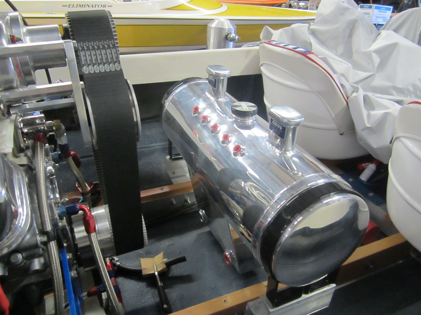

Have a Enderle Hat deal I'm thinking about running for a bit, This set up was (still is ) complete It previously utilized a bullet tank mounted high on the transom fed initially by a block mechanical pump to then gravity feed the enderle injection pump , the bullet tank also simultaneously returned fuel continuously to the saddle tanks to feed the mechanical , Question is can I feed the Enderle pump from my New Imco sump tank directly with my Aeromotive Electric and By pass/returm style regulator (eliminatiing the Gravity feed Bullet tank ) Thanks in advance Tom
Before
The tank I wish to use

Where is your fuel pump (the enderle pump) mounted? If it is below your tank than you do not need any help as the pump will always stay "wet" by sitting below the fuel level. You can not feed pressure to the enderle pump as that would cause some problems. The reason the other tank was mounted high was to make sure the pump would be primed. MFI pumps are not all that great at suction, which is why they did not just have it draw from the saddle tanks in the last boat.

Thanks Paul Kind of thought this but was hoping to avoid the homely little Bullet deal , Enderle pump is cam driven Thanks Tom

You could always do a belt driven pump set low so that it is even with the lower part of the tank.

My Buddy here has just done this (belt driven) on his Blown Gas Hydro his setup was using a similar reserve tank with Holley float bowls , anyhow he was coming to look at my deal tommorow, Thanks very much for the input !
bump the tank up about 4 inches you will be fine
Thought about this as well , the base of the sump is about even with the Dampner might take 6" ish to get it closer to the Cam centerline, again Appreciate the info Tom

If you get it to where 75% of the fuel is above the pump, you should be ok. It could be a bit of a bear to get it to re-start if you try with the fuel level low... but once it's running it would keep primed and be fine. Having the fuel higher is always better... but look at funny cars and dragsters... they do not get that luxury... but then they also do not need to re-start with a partially full tank.
