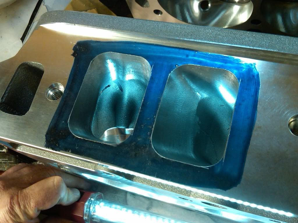

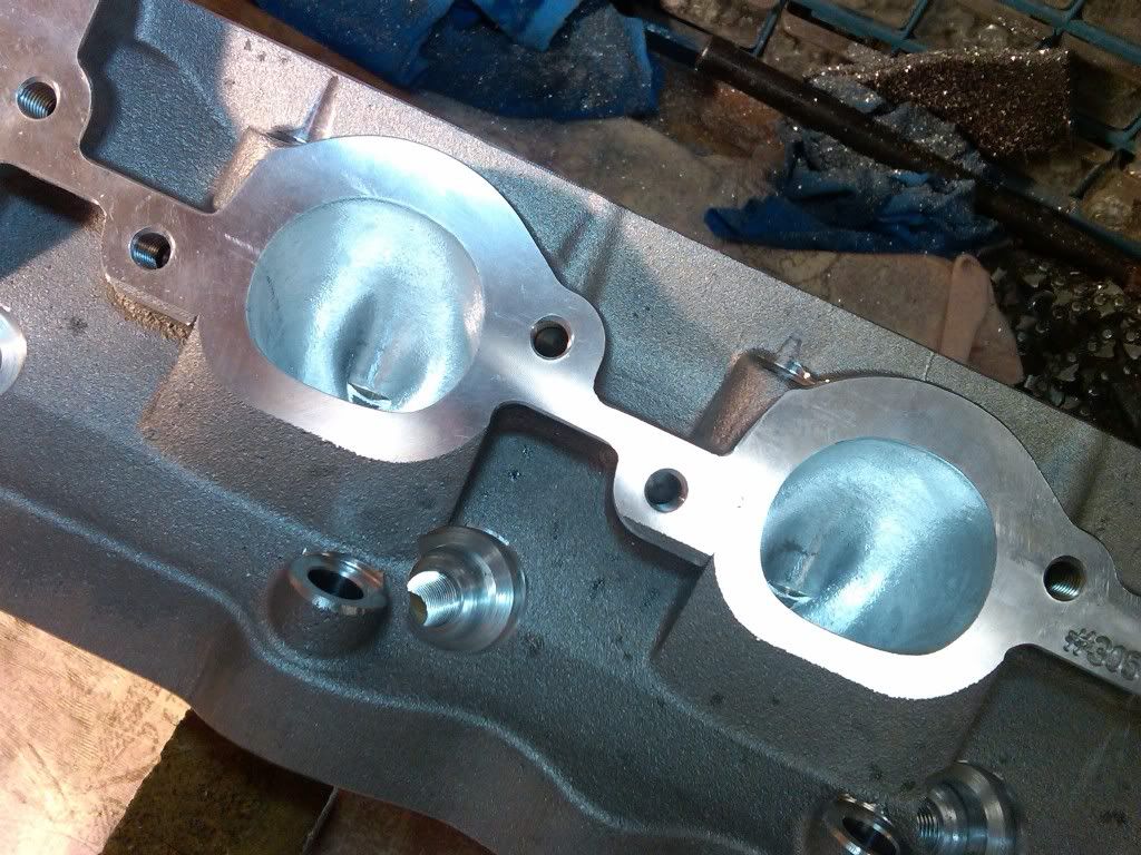

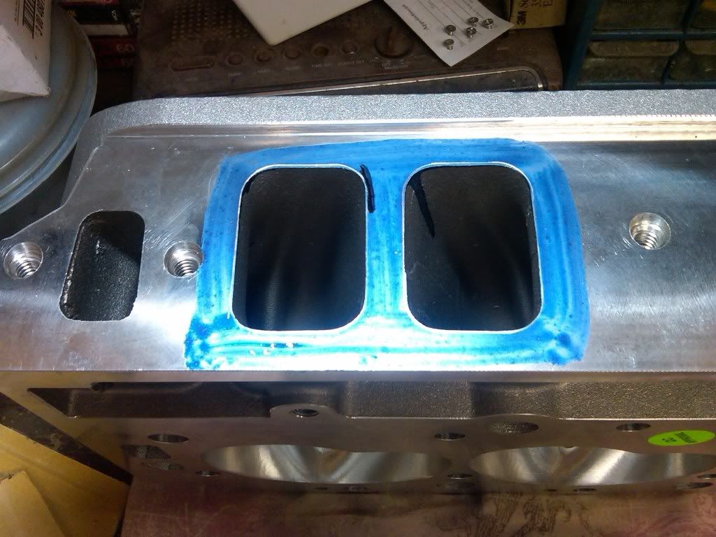

Well being that I just can't bolt something together I took a grinder after my new aluminum heads. :))eek:))
Intake ports layed out
Intake opening roughed in
Exhaust bowl roughed in
Exhaust ports roughed in
Well hopefully I haven't screwed them up to bad. lol :bangmyhead:

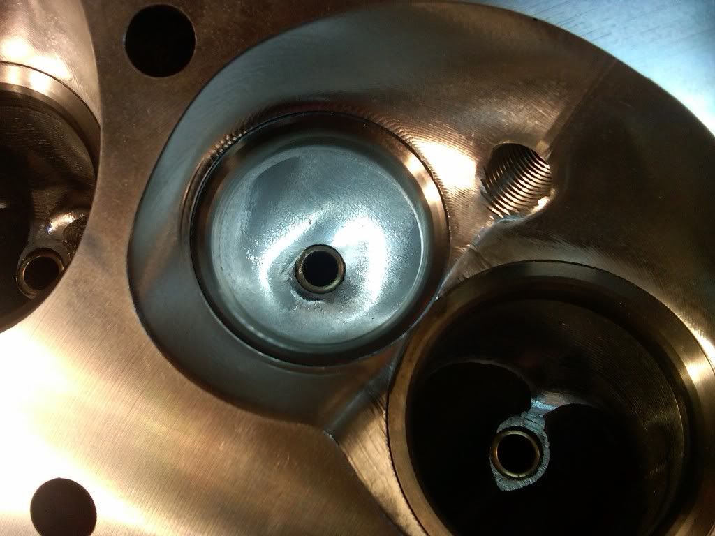

WTF!!!! You did write a CNC program for them. What, you sooooooo busy at work now?
Glad to see you got the CNC chambers, BUT, I may be wrong, but Steel should be along at some point and tell you to get in there and clean up the area where the exhaust seat is sunken in the chamber roof. I'm guessing.
Sorry Bob this is all by hand I've had to work too much at work. lol
The exhaust is not as bad as it looks in that picture but the cnc chambers could use a little clean up IMO. There's a couple of places wher the program transitions that I don't care for. And yes I put this thread up for critique and opinions so by all means let me have it. :)hand

A few updates 3/7/12
Well I got a chance to work on the intakes last night so here's what they looked like after being rough shaped with the carbide burr. I hope to be able to finish them out next weekend.
