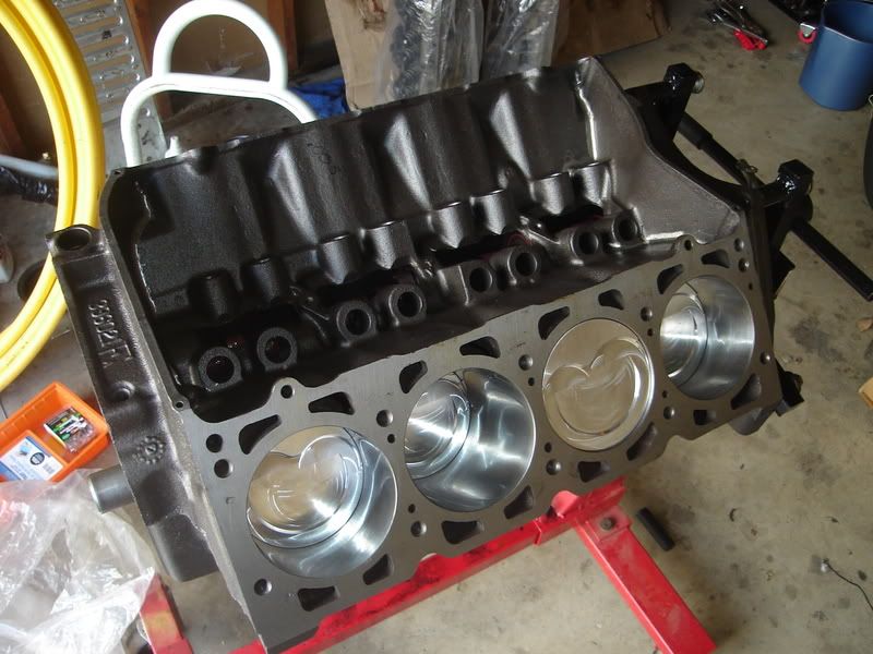

I've got KB pistons in my engine right now with no problems so far. I've also done a few searches on hyper pistons and there are a lot of people using them in performance engines, and just as many saying to stay away from them. If I had to do mine again, I might go forged just for peace of mind...
BTW, my engine is basically the 574 HP build from this book...
