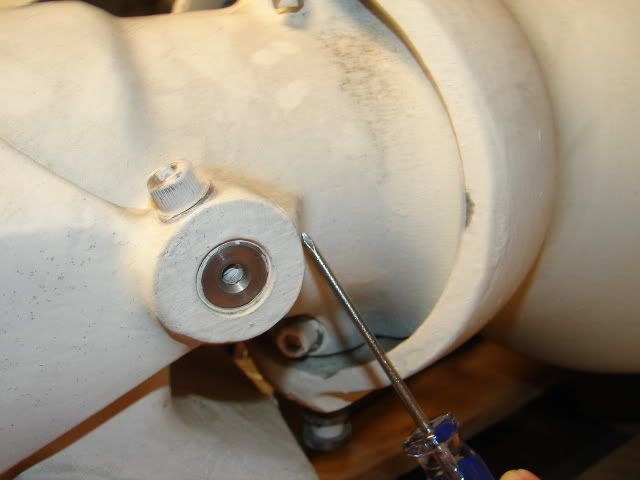

Pwr/S/W/Sm : Happy to help , the pic shows the area for a tiny steering "stop" (easily fabbed with a small stainless allen head bolt , chances are some "combined" wear in the Nozzle and or "nozzle adaptor" area has likley allowed the pivot to exceed the edge causing the thrus to "blow out" the edge of the seal ring , This could actually cause your steering to lock up ! Be carefull Tom
Cool Tom thanks again for all your help with everything and going that extra mile. You'll be in business forever with your fantastic practices. :)devil:)devil
