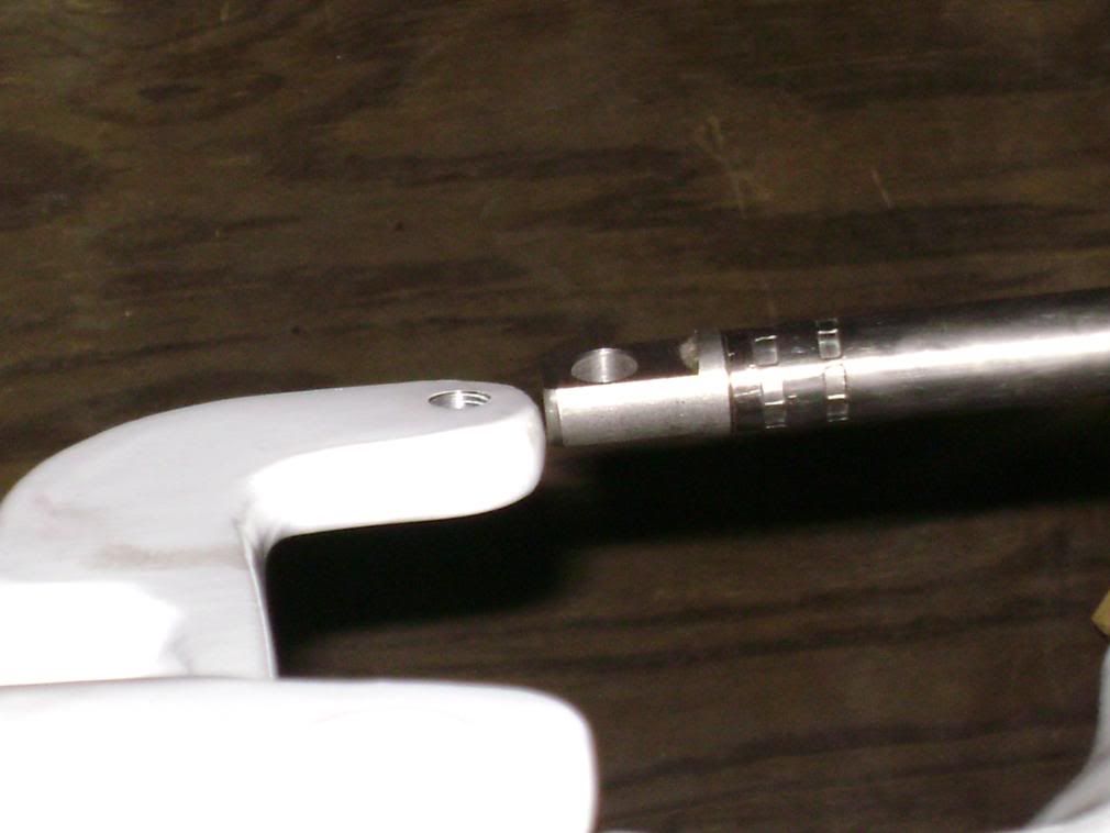

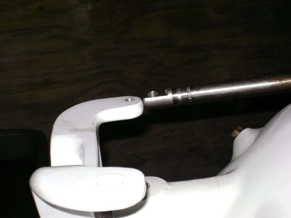

I got my new Place Diverter in today and it's a very nice piece. Unfortunately, like everything else on this boat, it's giving me problems with the simplest of tasks. Here's some pictures, they say more than all my words ever could. This is pulled up as far as it will go. I think something might be wrong. Please help me. I am trying to get the boat in the water this weekend, so I don't have a lot of time to figure this out.
Thanks in advance!!!:D

Adjust your steering tube out more. If it won't go out anymore, turn the tube over and then adjust it that way.
Also, it looks like your going to need a pivot extention to attach the arm to the cable.
1,189 Posts
make sure your steering tube has some play in it, it shouldn't be tight to the transom adapter. that should give your cable enough play to be able to bolt it up no problem.
1,189 Posts
the steering tube is the aluminum threaded pipe looking piece that your cable goes through, make sure that it has some movement to itm that should fix your problem. if that doesn't fix it then take the steering tube out of the transom adapter and swap it end for end, this will give you more tube out of the adapter and allow you some more angle.

they're tryin to tell you to leave the tube loose where it passes thru the transom adapter, thataway you can bend it upwards or downwards to get the angle on the arm right:D the tube should be sealed with rubber, which will still seal just as good at any angle other than straight out.

Looks like the swivel connection kit will solve all your problems. ;)
Part# MOR300618
http://www.rexmar.com/page120.html
Yep, that looks like a winner, but that means I will have to wait until next weekend to get it wet.:( Takes a week to ship things from Cali to here.:|err

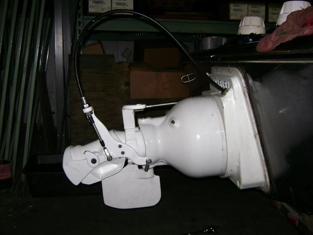

I just installed the exact same connection swivel from Rex Marine:D Works great, steering is smoooth.......... Hope these pics give you a better idea of what it will do for ya.........

As you can see in the pic above, my tiller arm was ground down for that reason. Or if you had a split bowl, i would say wedge it...... But you don't sooooooo.................Get out the grinder:D

Thanks for the pics, these should help a lot when I go to make it.:)devil Probably going to go in after work and hammer one out real quick, shouldn't take more than 30 minutes or so.:D
