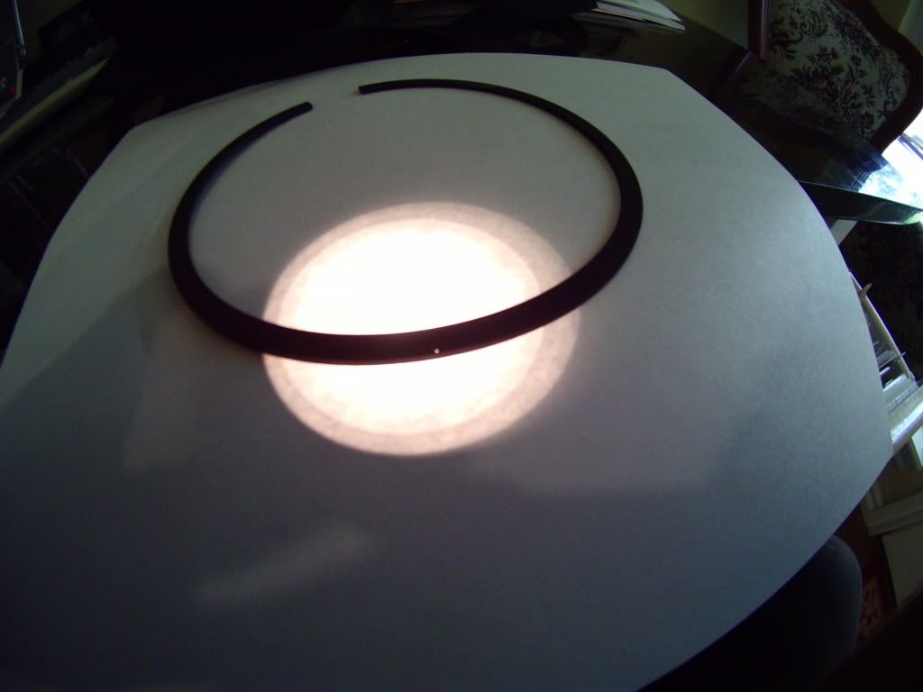

Better really keep your eyes open when assembling one of these things because it seems that quality control is out the window when it comes to our parts anymore. I was file fitting my Sealed Power HellFire rings yesterday and got almost to the last cylinder and found a pin hole right through the second ring. They are sending me some replacements but dont you guys think that this should have been caught? Sure glad I saw it.

That was their top secret R&D sealing port. Lucky you discovered it before everyone found out.

WOW- just gonna start filing mine (same hellfires) guess I'll be looking for that for sure- thanks for the heads up:)bulb

I'll venture a guess here that they don't inspect every single ring. They're most likely batch tested at certain intervals. These are not a high dollar ring, but more a production performance ring.
Good catch Hass...I hate to say it, but that's your job as the engine builder. Someone less thorough would have missed it. ;)
You're really just showin off, aren't ya. :D

I took the ring and pulled the gap together and it broke right were the pin hole was. Certainly would have broken if ran. Porsity.
