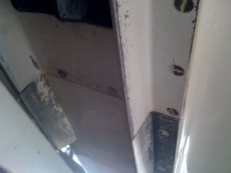

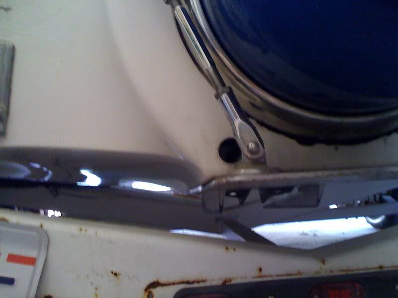

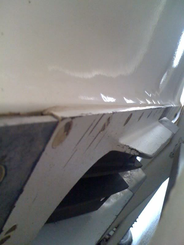

This is the kicker for me, I get up under there and for the first time it totally hits me how different my intake is compared to everything else i have ever seen. Which is funny because i have been under my boat many times, but just never fully realized what i was looking at. here are some pics of the bottom of my 20 ft sanger mini cruiser, let me know what you think about it, cause i have never seen anything quite like it.
AP
looking from the back forward.
the fins that extend from the front of the intake forward (you can barely see where the mount of the intake is at the top. this is looking forward)
the back of the boat has a very small pod section that extends about 2 inches past the rest of the transom.
you can really see the drop down section...almost tunnelish like. its is completely flat in the center and is about 2 inches lower than the rest of the bottom.
this picture gives a good perception of how the bottom is and its shape.

Yours is Berkeley "drop thru" intake somewhat unique to Sanger boats (as were the transom adaptors) the jets wont generally come out the back as is customary .The bottoms on that and the 18's were similar to a "Pantera" bottom I've had several of these boats Tom

Same intake and fins in my hydro. It's a Sanger deal.

Tom, I had a feeling it was specific to sanger, and i have seen the superjets and sprints, with that small "pod" on the back, built into the transom. But my main thing is that the intake is actually bolted up from the bottom of the boat...not set in from the inside. is the "drop thru" refering to the fact that if it wasn't bolted and epoxied up in there it would "drop thru" the bottom??
have you ever done any setbacks on a sanger with these types of intakes?

The intake is already flat. Go get a shoe and bolt it up. Plenty of room for plate adjustments.

You might want to try trimming your loader before adding a shoe. The ramps look like they are hanging awful low.

yeah, i had it out once already trimming it way down. right now i noticed only small differences, but was doing a little bit at a time (mainly to see how different it acted) the thing is that i was only doing 61 mph on gps at 4600-4700 rpm. my plans have always been to step up the power, but was playing with what i had to see if i could get a handle on how it might act at higher speed.
before the big hp engine goes in, it will be trimmed again cause it is still pretty far down right now. what kind of intake pressure do you see with that shoe? did you make that? how far down does it hang?

It's a 1/2 inch with a two degree taper. I'm sure Tom could hook you up with a shoe. Don't have any numbers for pressure.

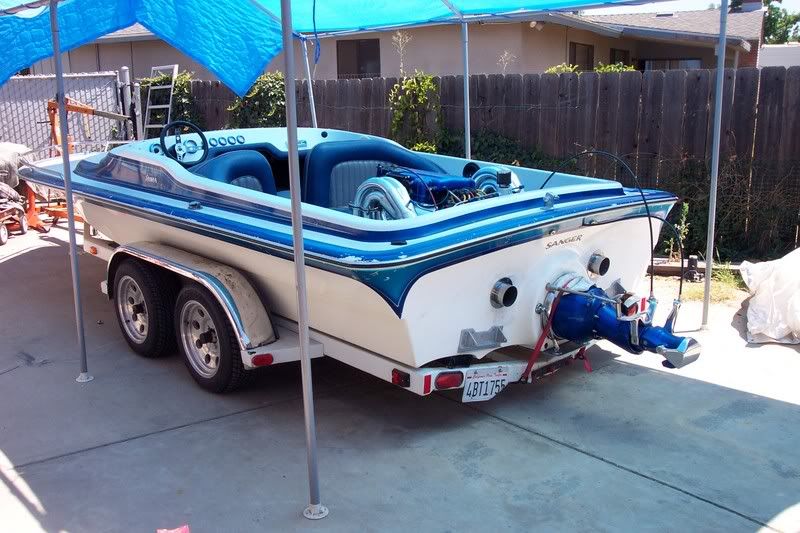

Had alot of issues from that particular Sanger Jet and always considered that it would benifit from simply "starting over" with a set back standard Berk or AT/Dom or ?? intake ride plate and shoe deal Tom
just sold this Sanger boat to a guy in Texas his biggest compliant (I've seen the pics) is that its way too "wet"
BTW here some pics of the Sanger circle boat , tell me this guy didn't have time on his hands (pinstriped intake area)

this one is identical the the super jet that i used to have. that one must be a 73 or 74? i too had some issued with it running really wet, but it had a droop on it, and no diverter. my current boat...the cruiser, really runs very dry for how big it is. it seems to get right up on top of the water and runs on the back couple of feet. i'm hoping with some more power it might really lift a little and run pretty hard. I have never seen anyone put any kind of big power to these sanger minis (except the v-drives) so i'm anxious to see what i can do with it.
