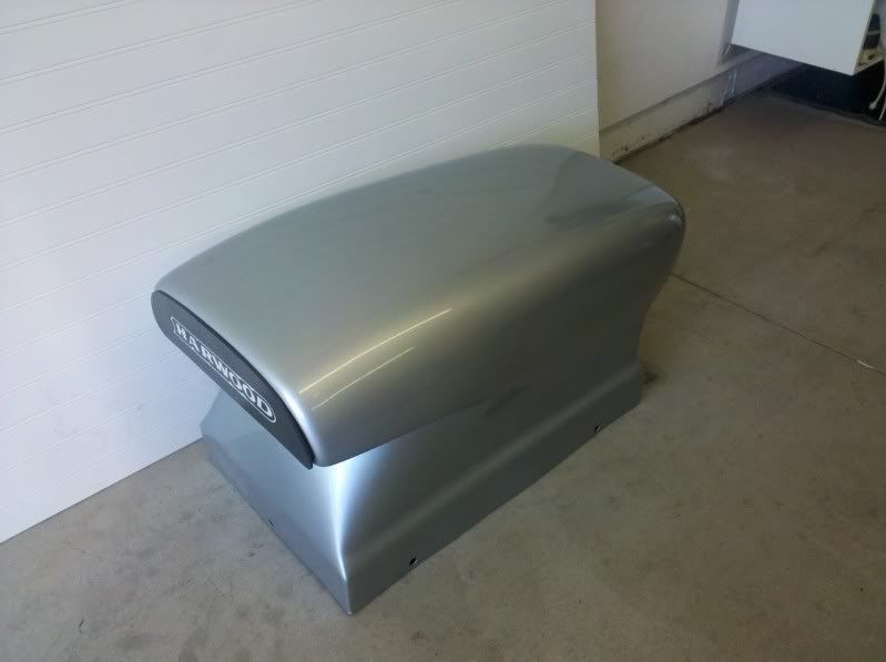

the tray attaches to the engine and carb,the scoop goes on the tray.the holes you see in the bottom of the scoop usually get dzus fasteners to attach it to the tray...........hope this helps

Looks to be a single, and from the looks of the valve covers its a SB so more than likely not a dominator?

The tray is for a single carb set up on a Holley. The whole deal is done right. There are pins which hold the scoop to the tray and the tray has 4 reinforcements to attached to the block. Nicely set up. Let me know.
