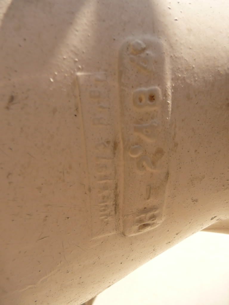

That #, H-2484, identifies that part as a JE/JC one-piece bowl. It does not identify the basic pump model as it can be used on all the Berk models, except the JF(would need some mods to fit the JF). To identify which pump you are dealing with, find the oval plate riveted to the suction housing above the thrust bearing.

it's a 12 jc-a-h any good?
It's the basic Berkeley pump with no split bowl and an A cut impeller. Lots of boats came with that pump.
You can convert it to a split bowl model if you want. Then you'll have the ability to mount droop snoots, rooster boosters, etc etc.
